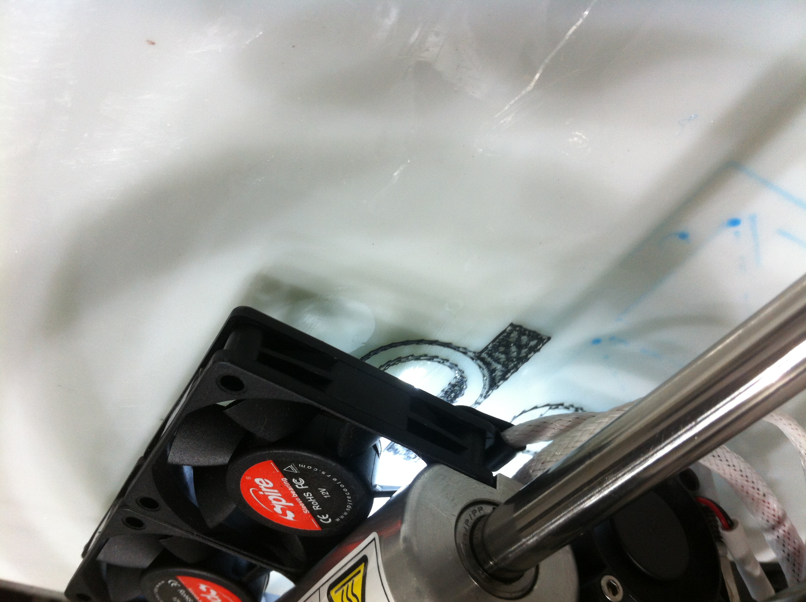

My first impression was that with kisslicer the prints are immediately better. I solved right away the adhesion problem. Now I have somehow the opposite, it is difficult to detach the part from the base. It depends a lot on the hardware Z Gap that I have to set before every print, at least twice.
Still I find some things I'd like to improve. Here is a bit of a list with pictures:
  1. If I do not have a skirt for the first layer the ABS comes out spotty from the extruder:
    Spotty first layer
    Spotty first layer

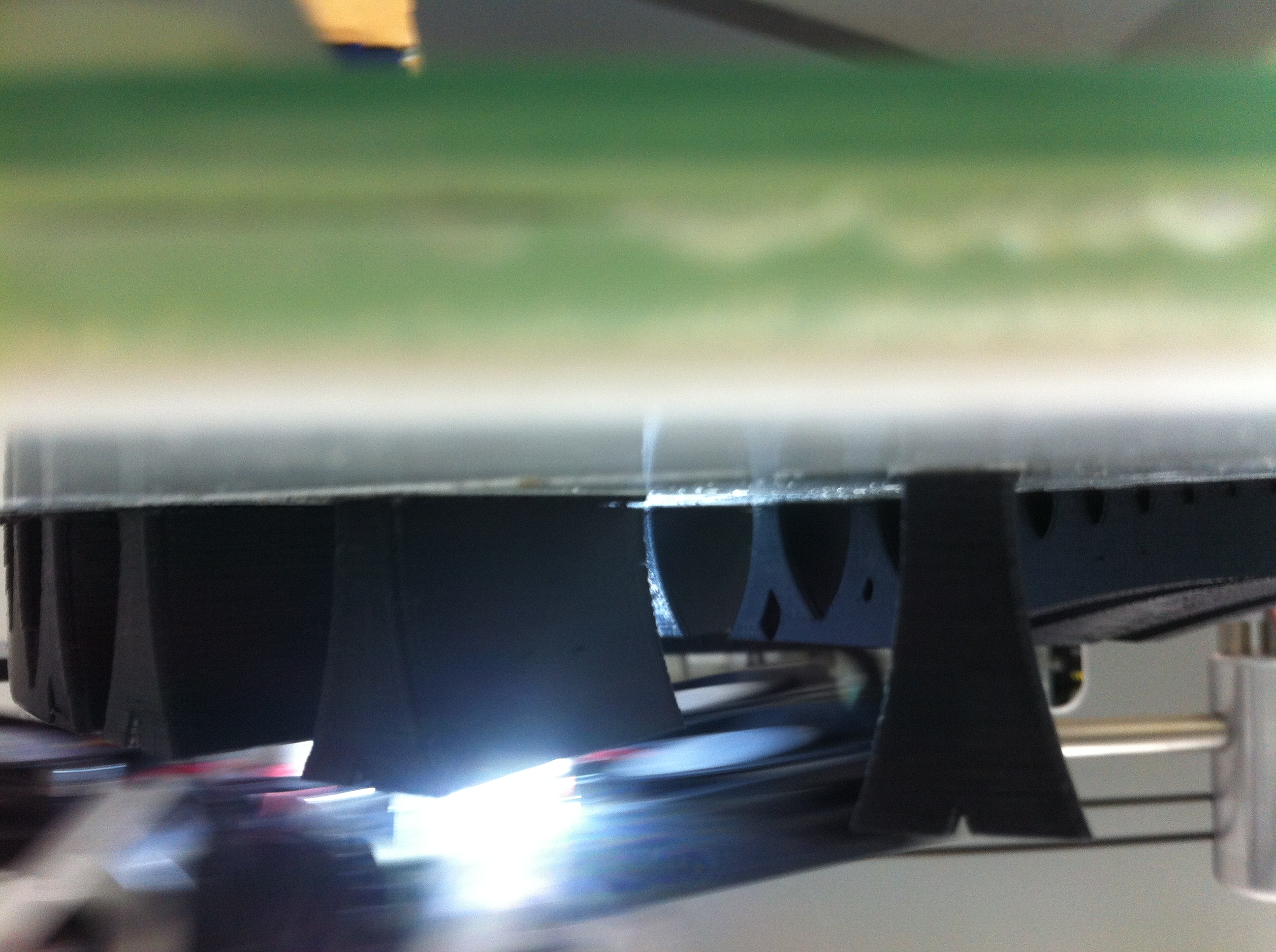

  • Sometimes the print seems to be delaminating or the ABS fails to stick to itself properly:
    Some failure to stick to itself in the dead center of the photo
Settings for ABS are:
[ABS Cubex Thickness 0.1]
g_code_matl=3B204D617962652073657420736F6D65206D6174657269616C2D737065636966696320472D636F64653F
fan_Z_mm=0.3
fan_loops_percent=100
fan_inside_percent=100
fan_cool_percent=100
temperature_C=260
keep_warm_C=150
first_layer_C=270
bed_C=100
sec_per_C_per_C=0
flow_min_mm3_per_s=0.01
flow_max_mm3_per_s=10
destring_suck=0.035
destring_prime=0.1
destring_min_mm=0
destring_trigger_mm=0
destring_speed_mm_per_s=110
destring_suck_speed_mm_per_s=50
Z_lift_mm=0
min_layer_time_s=8
wipe_mm=0.1
cost_per_cm3=0.003
flowrate_tweak=1.11
fiber_dia_mm=1.7
color=65280
Any suggestion?
Massimiliano
p.s. somehow the images are upside down. Sorry
