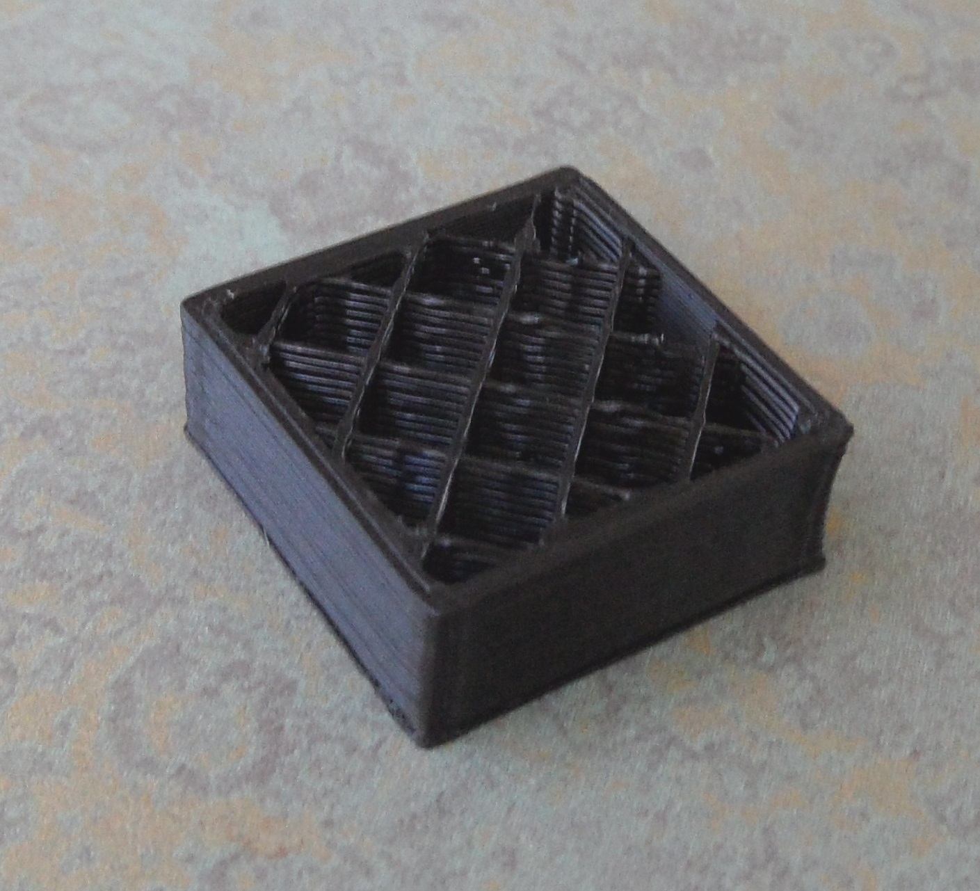

There seem to be some inconsistency with my CubeX PLA filament. It's not breaking but must be getting old.
When I ran the same prints with MatterHacker ABS filament all was better. The infill looks normal now.
I got to keep in mind how much difference the filament can make.

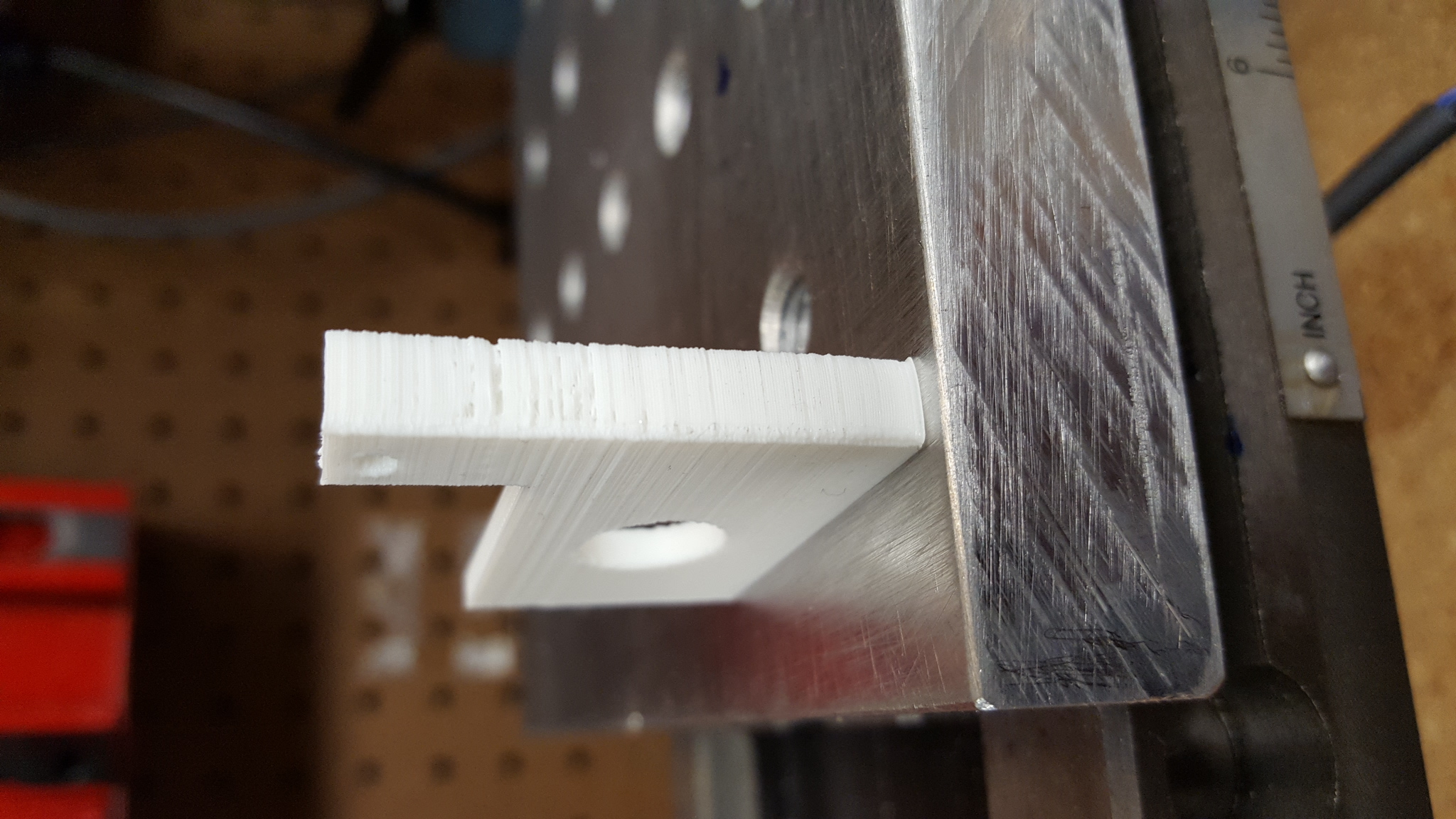

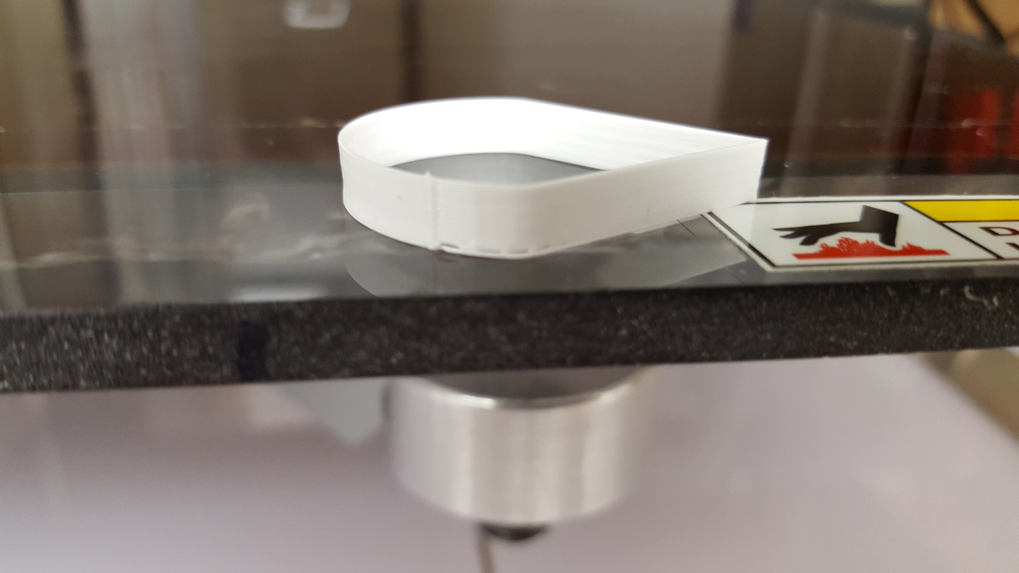

What setting will help close up these gaps especially on the short section (pic2) matterhackers PLA

joestefano wrote:What setting will help close up these gaps especially on the short section (pic2) matterhackers PLA
Hi,
first set M228P = 0
use M228P only when you have a blob at the beginning of the path.
if you still have holes reduce the speed M227S 0.03-0.02 and also the total length M227P 0.1-0.15, if one of these parameters is too big you may have some air aspirated into the noozle.

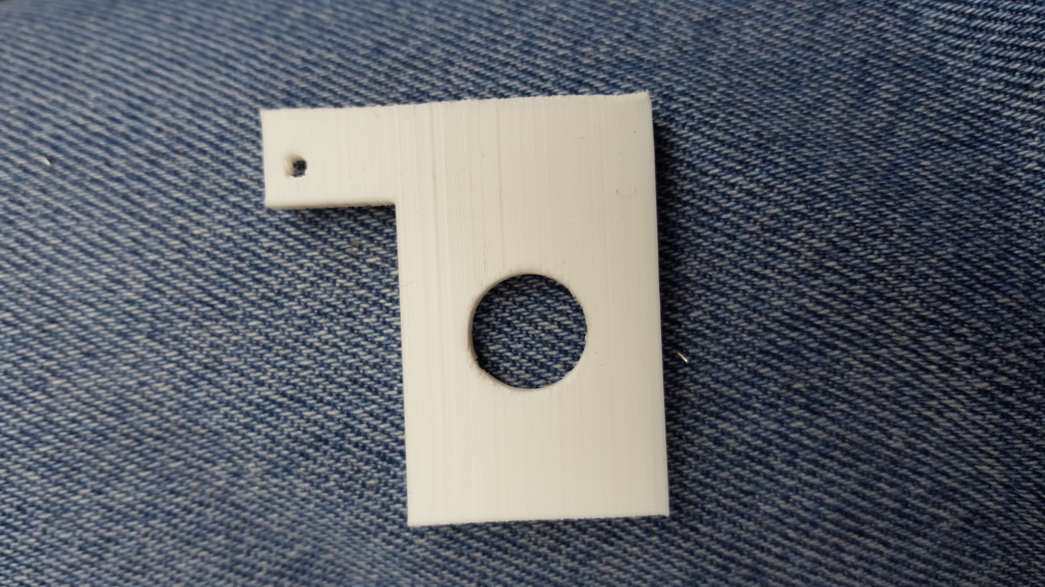

Giovanni, I worked all day printing the "fine tune" file. the only problem I have now is that after the first layer which is good and after the head returns from the heating position the 2nd layer is lacking right at the start by a very small amount. All the rest of the layers are fine.

joestefano wrote:Giovanni, I worked all day printing the "fine tune" file. the only problem I have now is that after the first layer which is good and after the head returns from the heating position the 2nd layer is lacking right at the start by a very small amount. All the rest of the layers are fine.
Hi,
print 2 parts, this way you see how M227 228 works when the head make long distances.
M227P should be equal or larger than M228S.
Your flow tweak is too high there's a problem somewhere ( filament diameter, extruded wall width, voltage of extruder...)
