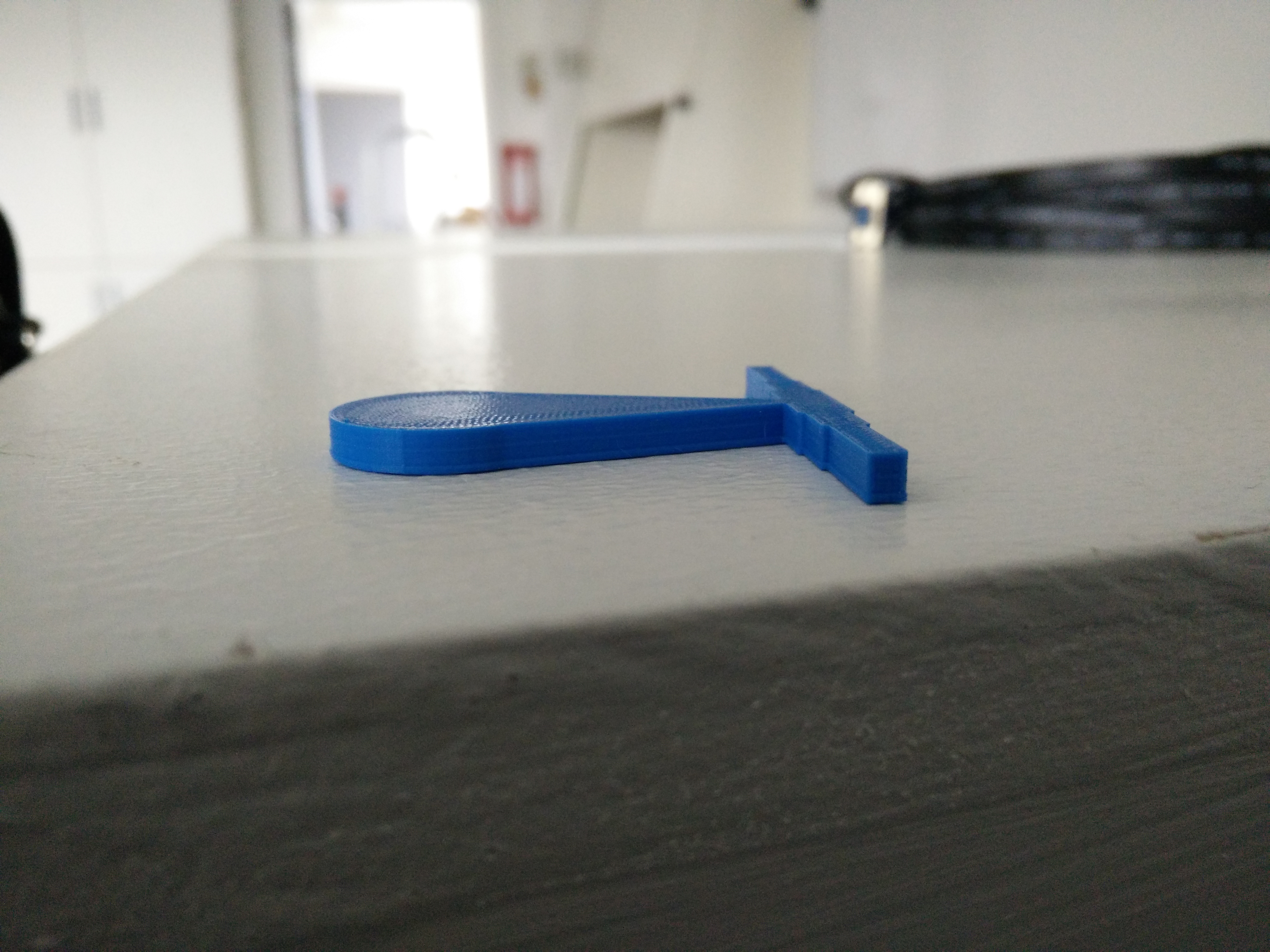

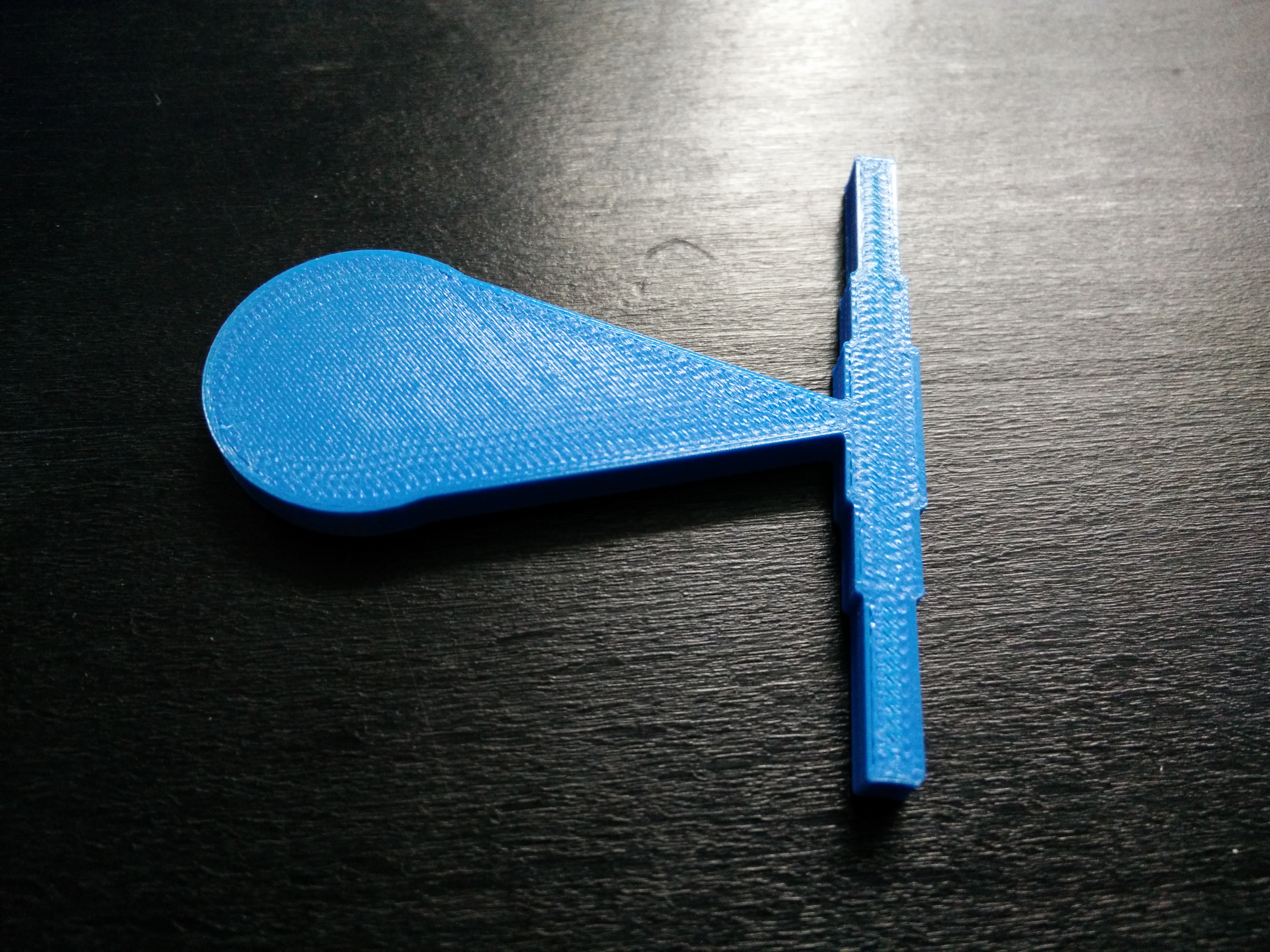

My first attempt with V6.05. I used the materials provided, other than changing the material diameter to 1.75 to better match my non-stock filament.
Looks very nice, except for the initial part of each layer where I get the impression I need something better for the M227/228 values...

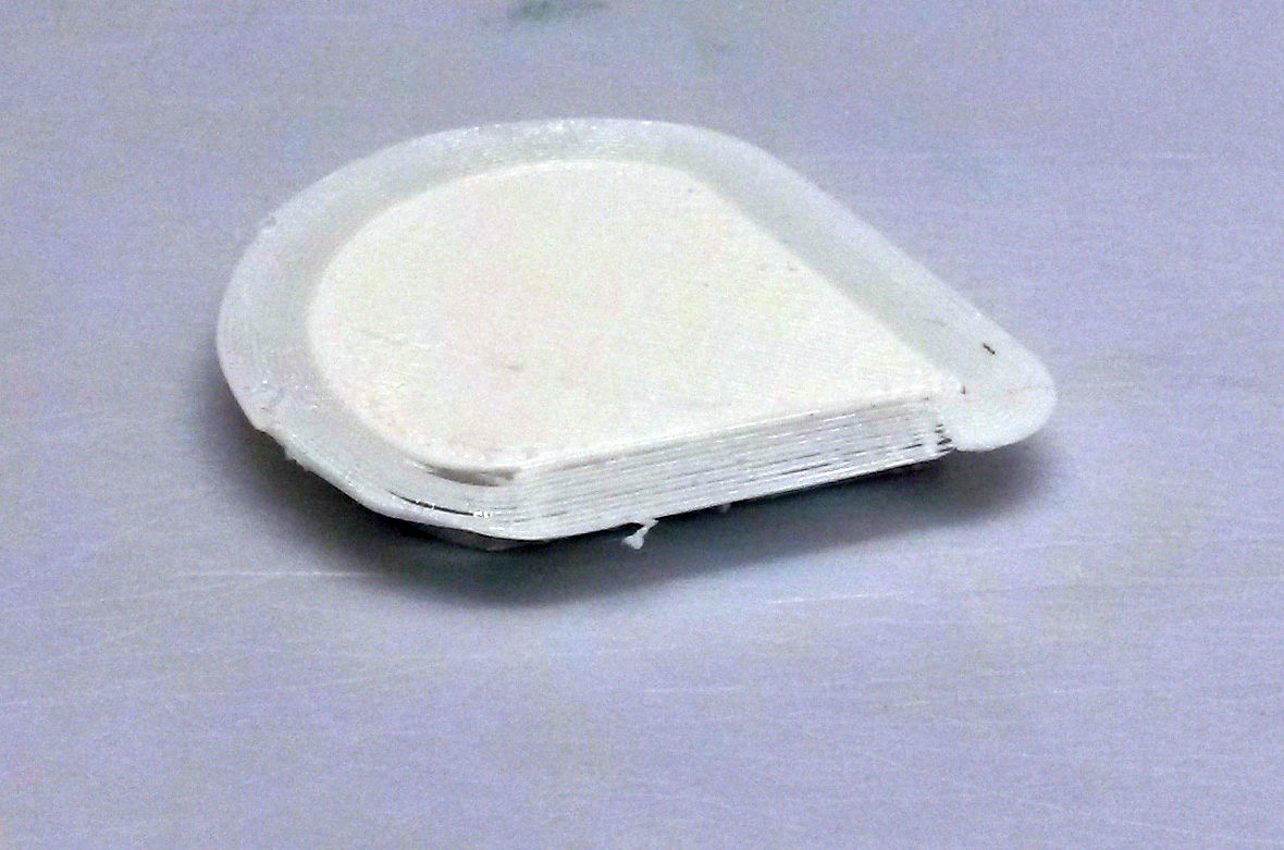

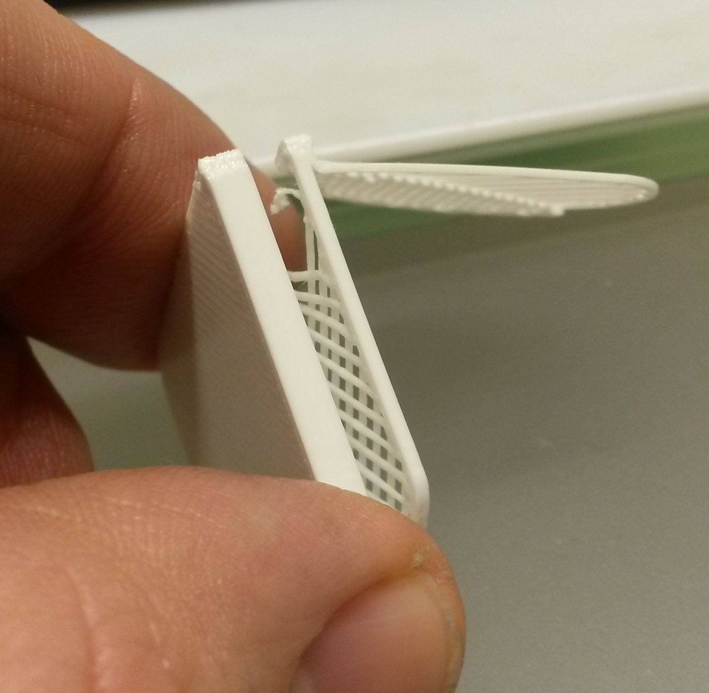

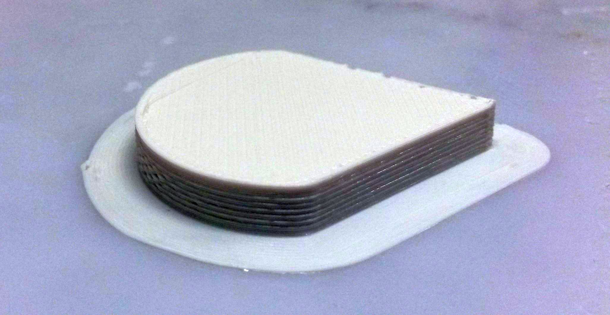

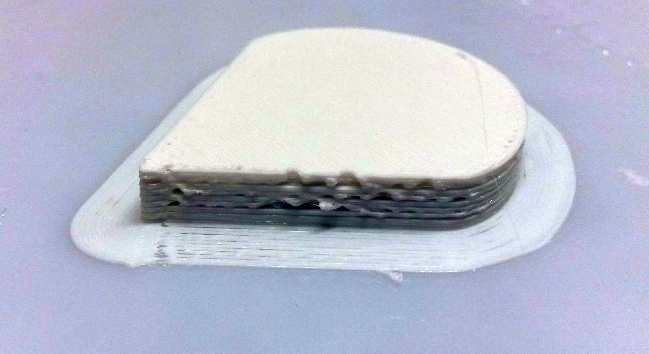

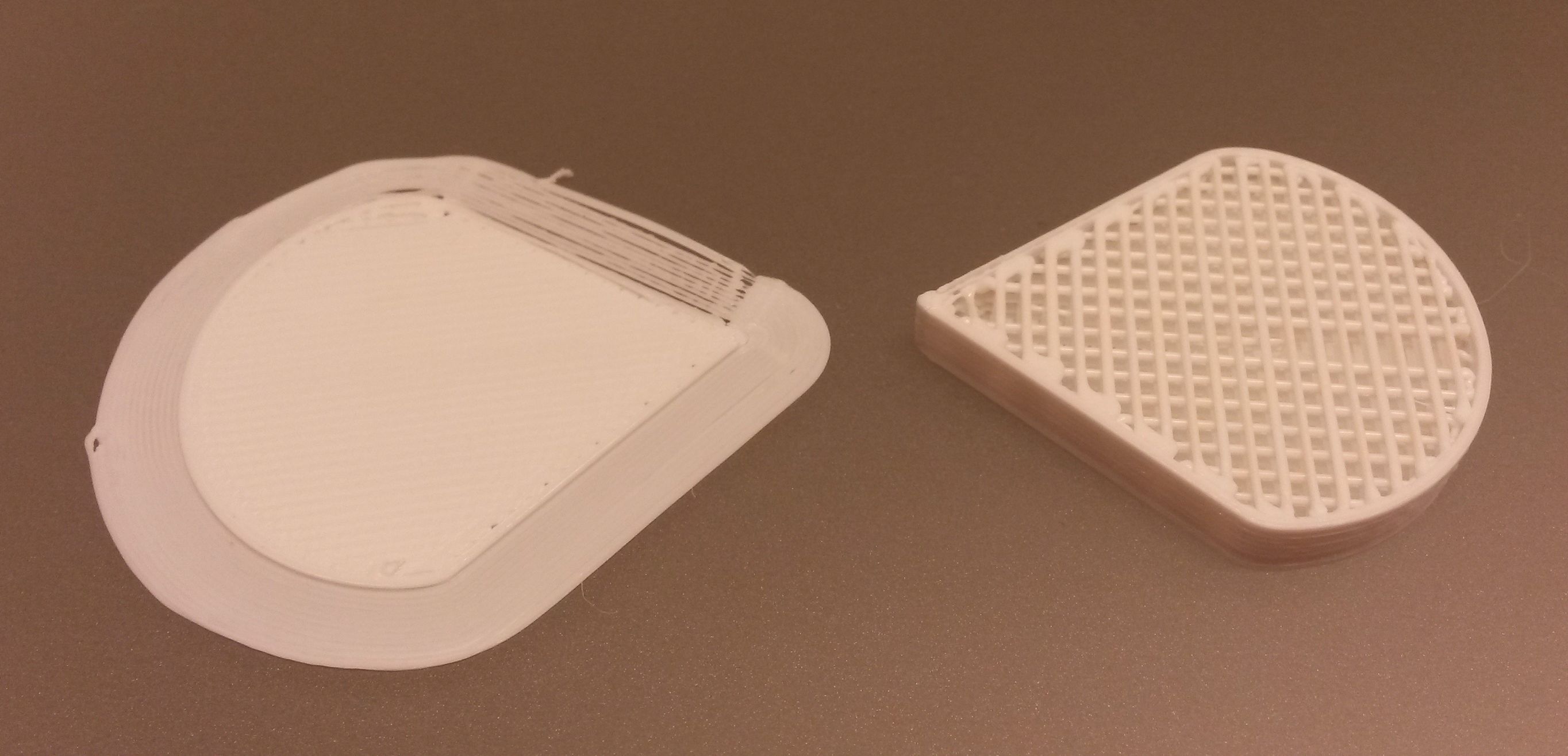

Here are a couple of extra images. I have been having problems with inter-layer adhesion. Also an interesting failure of the infill.
I include the BFB files which might be of interest.

Re: New Version CubeItModV6.05
CJWubex wrote:My first attempt with V6.05. I used the materials provided, other than changing the material diameter to 1.75 to better match my non-stock filament.
Yes this is a problem with M227&228, if you have good values of M227/228 for this filament from older Cubeitmod you can use them with Cubeitmod6.05 because there are no changes on the way the seam is managed.
CJWubex wrote:Here are a couple of extra images. I have been having problems with inter-layer adhesion. Also an interesting failure of the infill.
The settings into the ini files posted with Cubeitmod V6.05 are for a particular PLA, the 3DInk PLA, it requires different settings than other PLA.

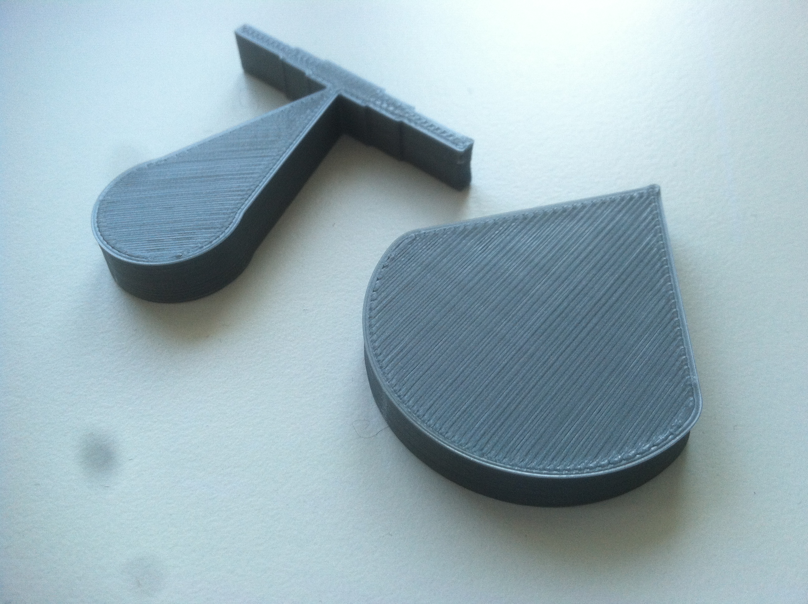

Here the test parts with the 3DInk :

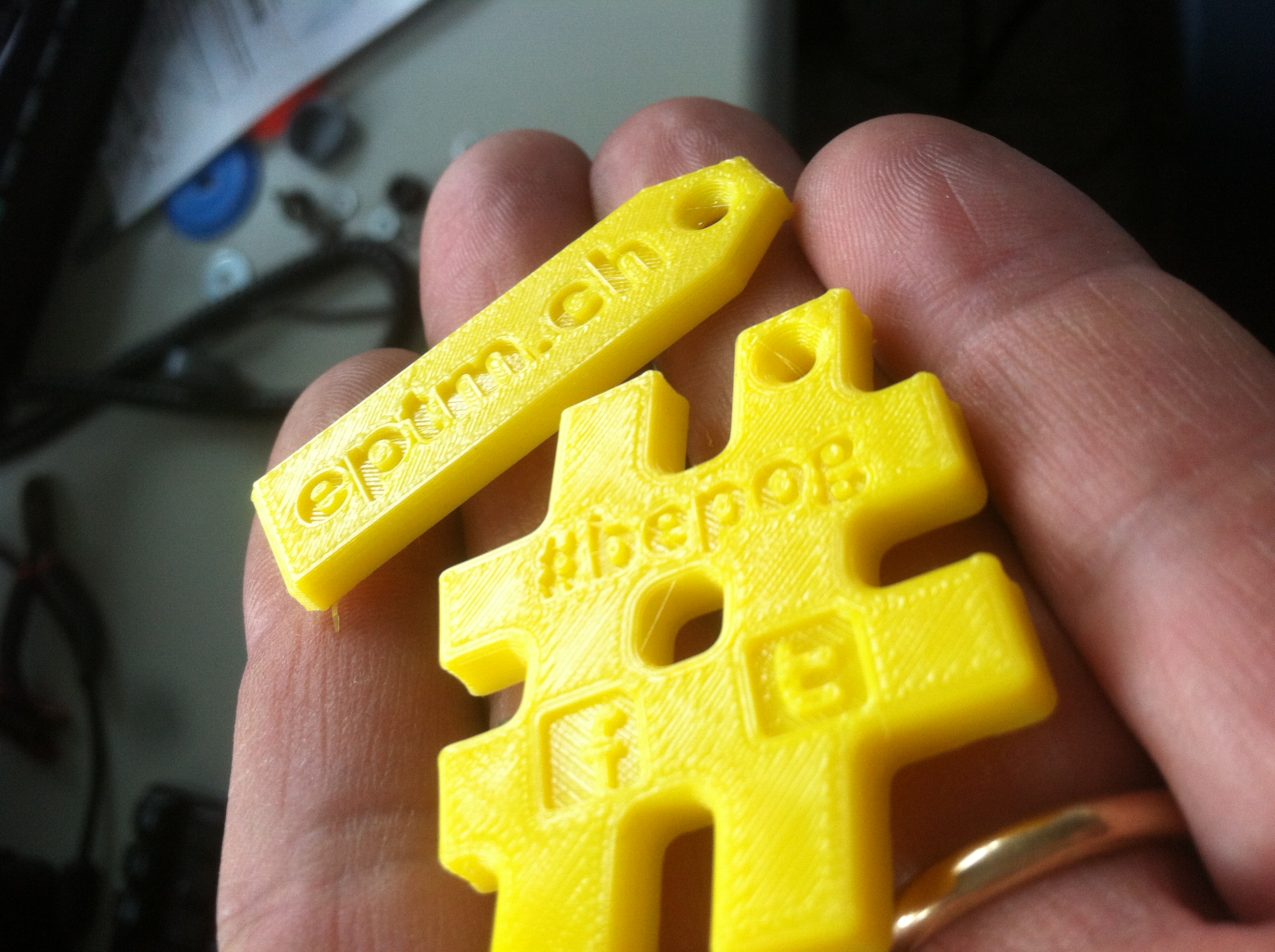

and here some small parts, still with 3DInk PLA, with with very difficult irregular surfaces, but CubeitmodV6.05 managed them very well and I've been able to print hundreds of these parts :
To print with other materials you better change M227 & M228 and seam gap and depth. If you have M227 & M228 , seam gap & depth of an older version of Cubeitmod that work good for your filament just use them with Cubeitmod 6.05 because the seam and M227&228 work exactly like into the older versions.

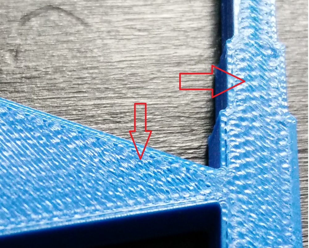

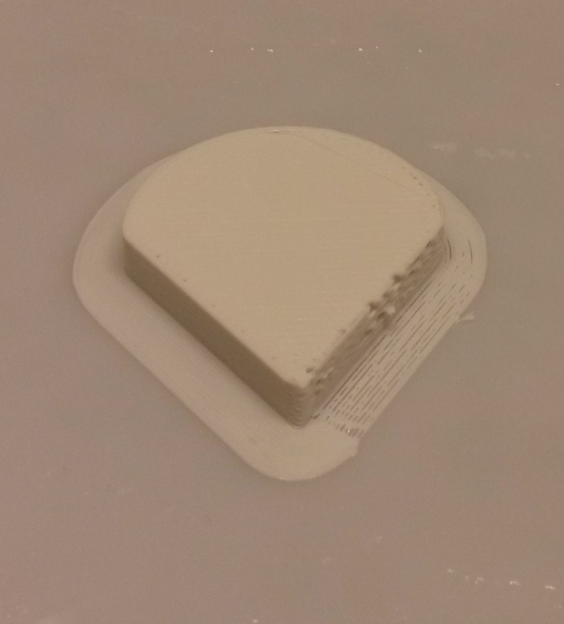

I just printet the finetune2-4mm.stl on my X.
Layer height 0.1 (I Know it should have been 0.09 or 0.12)
Style profile: PLA Thickness 0.1 Width 0.3
Material profile: PLA 3Dsystems Thickness 0.1 Width 0.3
I have added two pictures of the result.
All my settings are a stored here: https://www.dropbox.com/sh/kq5jzvd1cwnw ... KLG9a?dl=0
rantzaus wrote:Hei Giovanni
first I've to say the result is not bad at all.
The waves on the surface are probably a mechanical problem and are not related to KS/Cubeitmod.
Check the belt tension and put some grease on the guide bars for X and Y axis.
Are you sure the part was printed with "Material profile: PLA 3Dsystems Thickness 0.1 Width 0.3" ? because the ExtMap still shows PLA 0.2 width 0.5 !
With the help of the Excel file you can find the parameters to increase a little the RPM/Speed ratio for those solid lengths where you have small holes, longer segments looks OK :
