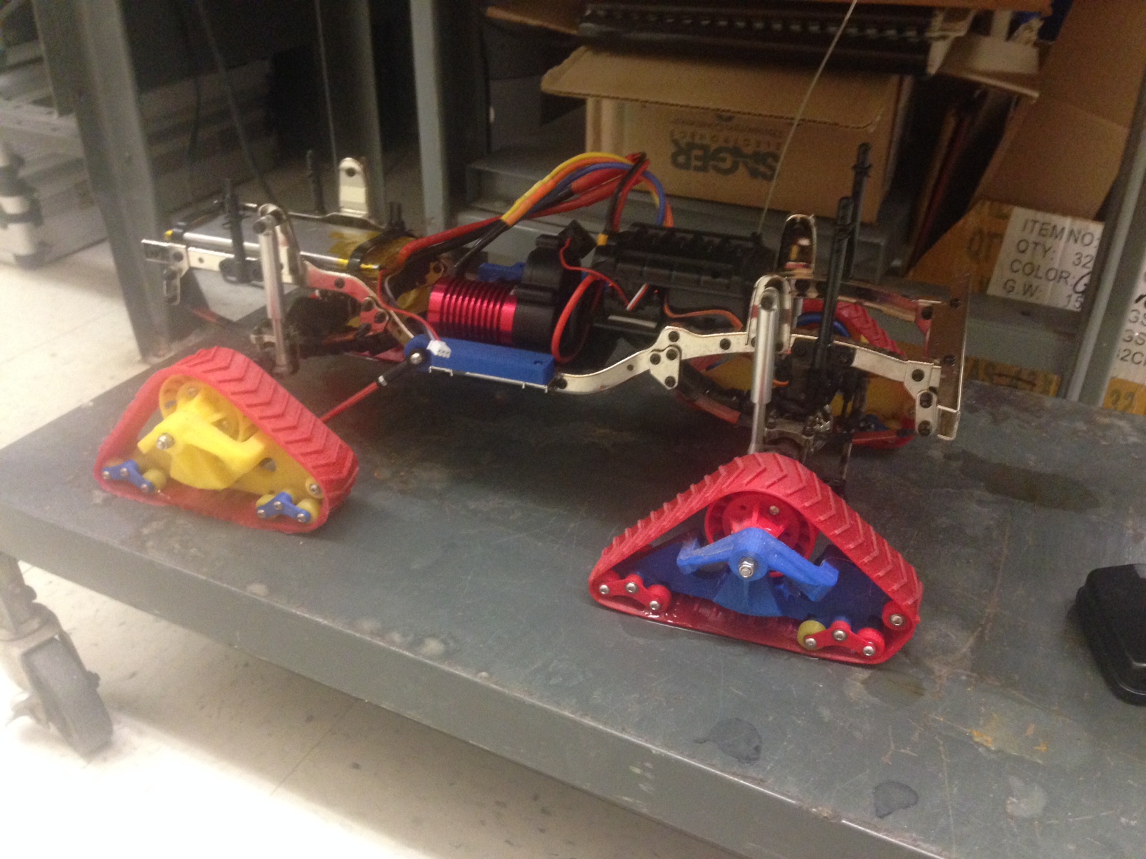

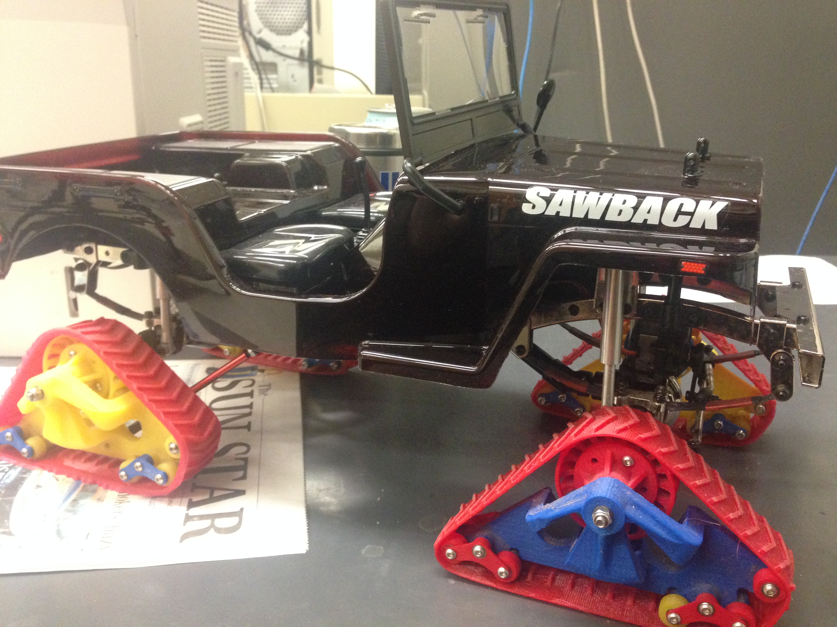

fully 3d printed track conversion for my RC car, including the rubber tracks (ninja-flex)
total of 88 ball bearings in the set.

I like this. Nice job!

thanks! i made a wider set of tracks for it and a jackstand for working on it (printed, of course!)
ultimate snow vehicle
trying to attach the pics
*edit*
does anyone else get the little dimples when it starts a new layer? any idea how to fix it? i guess it's a seam hiding setting, but i dont' really know what settings to use. i'm using .15 layer height and .4mm extrusion width, with a .35 mm (i think?) nozzle.
it seems like the extruder motor starts at full speed but the head accelerates at some given rate, which causes over-extrusion at the very beginning of each start. i dont' know how to fix this though

Yep, those are layer start blobs. Have yet to find any way to get rid of them. They happen when the head comes down after a traverse. There's always some residual material on the head surface, even if you have a "perfect" destring. The longer the traverse, the more ooze during it. I had hoped that the Seam Hiding and Gap would have alleviated much of this but they don't seem to have had much influence.

That is bad azz my friend. I printed some tires with the ninjaflex too, pretty darn tuff! Too hard for concrete, more like having drifting tires. Nice work!
