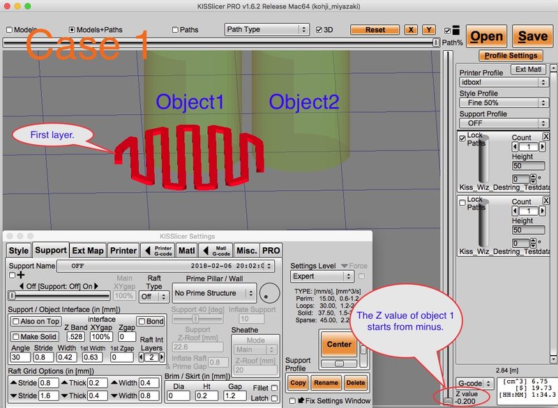

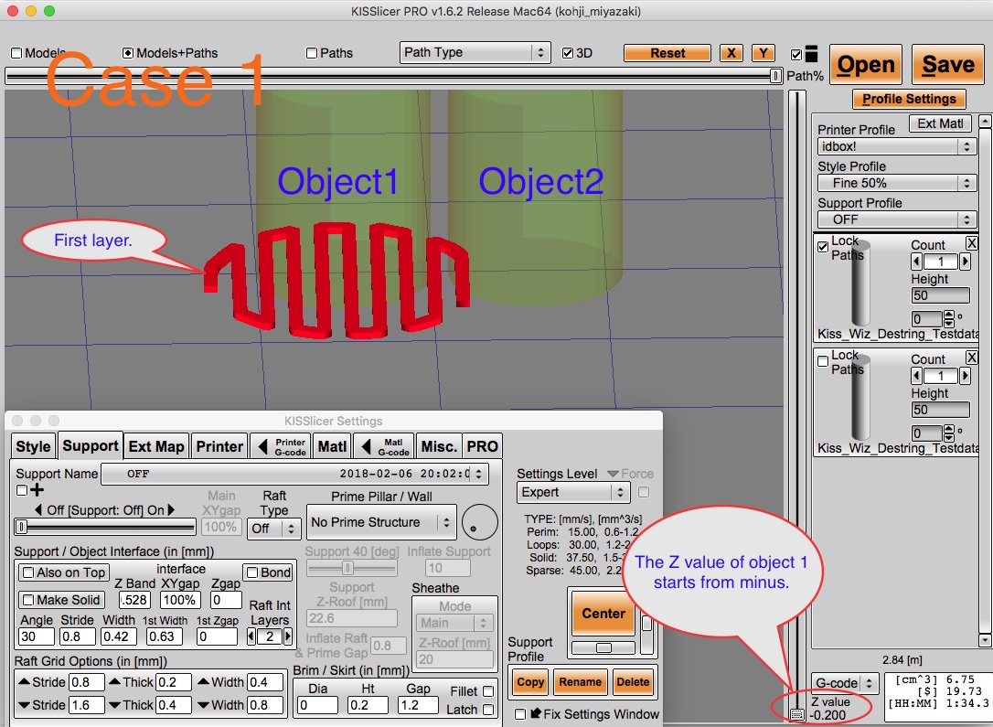

1. Z value is negative
Open Object 1.
Slice with raft and lock it.
Open Object 2 and slice it without raft.
The Z value of object 1 starts from minus.

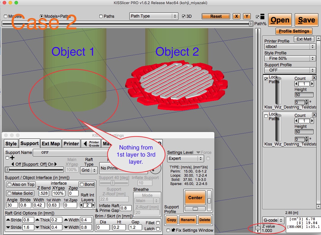

2. Z value not reaching the table
Open object 1.
Slice without raft and lock it.
Open object 2.
Slice with rafts.
The Z value of object 1 starts at a value away from the table.

case 1 screen shot
case 2 screen shot
