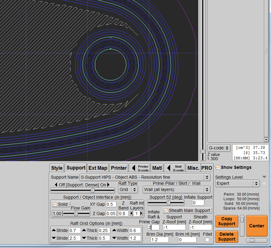

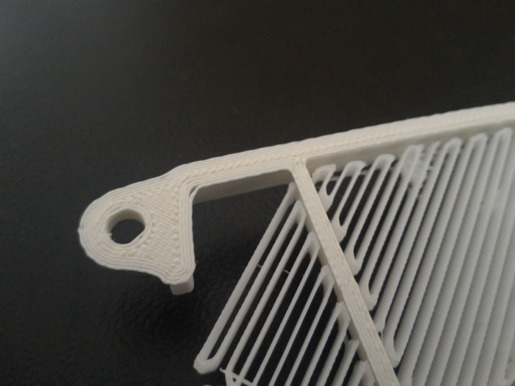

Hi
Result in pictures. 2 loops for birm with 0,8 brim diameter @0,2 layer height & 0,4mm extrusion, skin = 0.8, 2 loops from inside.
This is a print test.
I use brim to avoid little blob of the second layer grid support material just under the first layer of the object (see some of my older post).
Regards
Regards

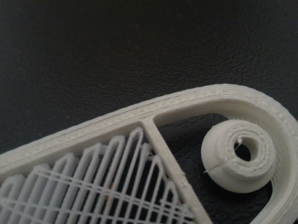

Re: No Brim Inside - KS 3.10
Hi Jonathan, hi all
After another slicing test, I found where it comes from :
with a 0.15 layer height, the brim appears inside because there is a small height difference (0,1mm) between the "rib" (internal) and the hull (external) of the parts.
Another point in favor of brim inside : looking at the holes, we see first layer loop+perimeter of each hole do not stick very well on grid.
@ Jonathan : thanks a lot for your works!
