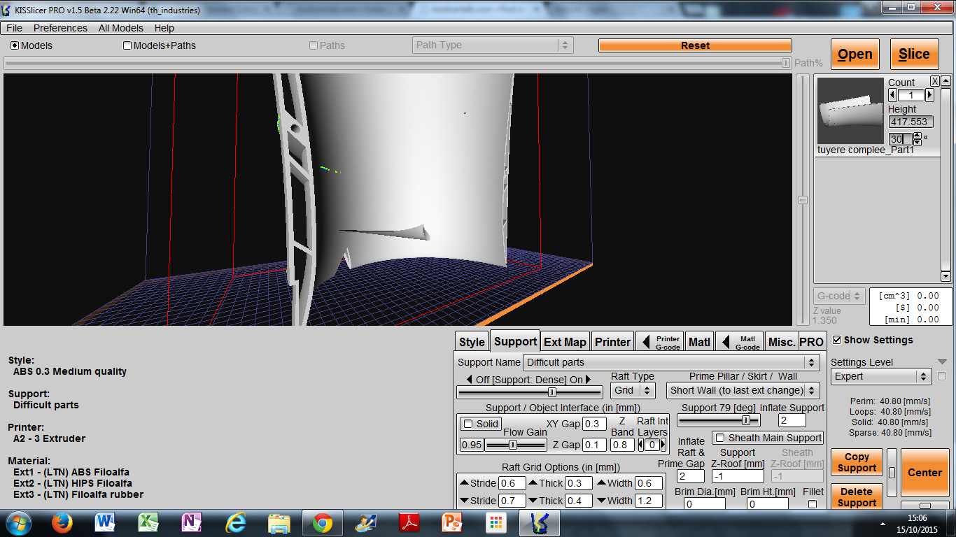

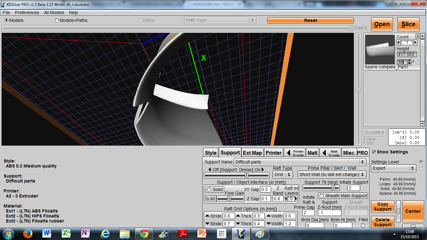

I want to sugest one new option. Let s imaginate a barrel with a specific part that is on the air like in the attach picture.
Is it possible to do something for create support just behind the the thin part and not in the barrel ? I though about the Z Roof Support but this just give us a minimum layer and in this case, will do support on an hard to remove zone. Can you introduce a Z Roof and Z " floor " to just allow to get parts which are beetween the two values ? Or an option that forbids to make supports on area with less than Xmm² ?

Have you try to design and add a part inside the barrel, then in KS/extruder map : use voïd on the mesh of the part you have designed?

could be very nice!!!MorganTH wrote: an option that forbids to make supports on area with less than Xmm² ?
+1
my dream : manage support on 3D view...by using your parameter (ex : 4mm2), when you click somewhere on the support /or on sub surface/triangle of the part or on a summit (mesh/triangle) of the part, it disappear...and let a 4mm2 "hole" in the support structure
Jonathan? :D
