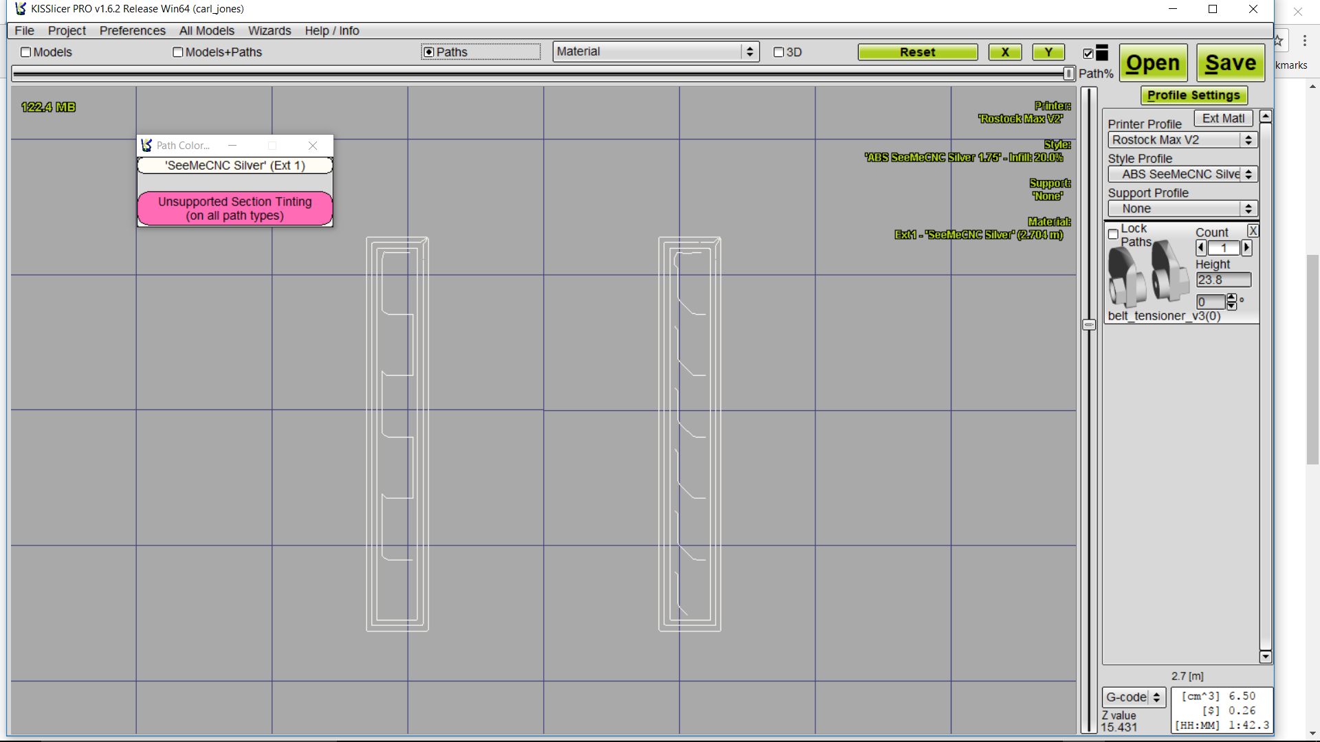

Hello, first post to this forum.
Searched several places but cannot find any reference to this item.
It shows up when I try to show path color key. No colors just silver or white.
Did I miss something in initial setup. Tried several different models and profiles, (don't have many profiles to choose from yet).
KISSlicer 1.6.2
Windows 10 64 bit
Thank You for any guidance.
CarlJ
Unsupported section tinting

I think we need a screen capture on this Carl. It is difficult to understand what you are asking.

Ok, hope this works, had to google to see how to do.

You have the path selector set to Material - so you won't see the path tinting. Change it to Path Type.

Thank You very much.
