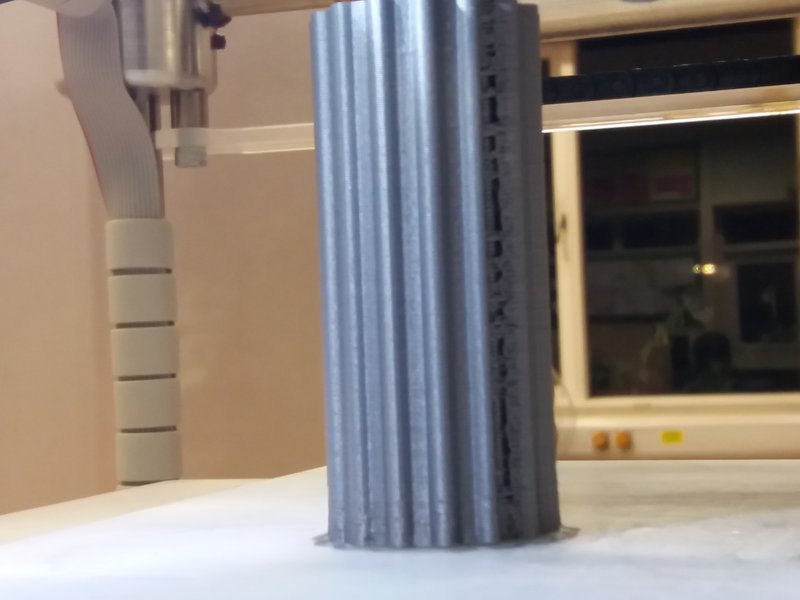

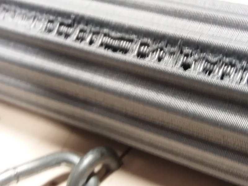

I have no idea if this is a common issue or even what to describe the issue as (please see photos). This issue has occurred at the point each layer is started.
Any advice would be cool!

Hello Grid!
Check this setting: Style -> Seam Hiding (In the lower right). Maybe these values need fixing.
(I have Depth 0.5, Gap 1.4, De-String on, Use Corners on, Wipe on, Angle about 45°, Jitter 0°)
Then check: Matl -> Destring (lower left)
Take care that Prime and Suck are the same values and not too much.
(I have good results with 3 mm)

TheGrid wrote:I have no idea if this is a common issue or even what to describe the issue as (please see photos). This issue has occurred at the point each layer is started.
Looks like a problem of M227 and M228 settings.
