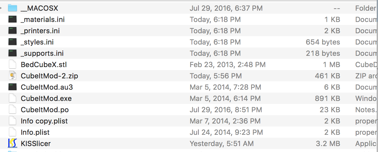

is there something else that can cause this error? i saved CubeItMod,exe in the KISS folder on my desktop and typed in "/CubeItMod.exe"<FILE>"

i am also using a mac. could i have the wrong version of cubeit? im running KISSlicer 1.2.0.1

Hi Rick,Rick wrote:i am also using a mac. could i have the wrong version of cubeit? im running KISSlicer 1.2.0.1
Cubeitmod is a PC program you cant run it into a mac.
You have two possibilities :
1- use Cubeitnet ( this is a translation of Cubeitmod into Mac code, but the latest version is the 6.03 )
you can find it here :
viewtopic.php?f=20&t=799&p=2691&hilit=cubeitnet#p2691
2- Use a virtual machine into your mac and work into a windows session, this way you have to run KS for PC and the last Cubeitmod 6.05.
I suggest you to use the second solution because Cubeitmod6.05 is better than 6.03.
