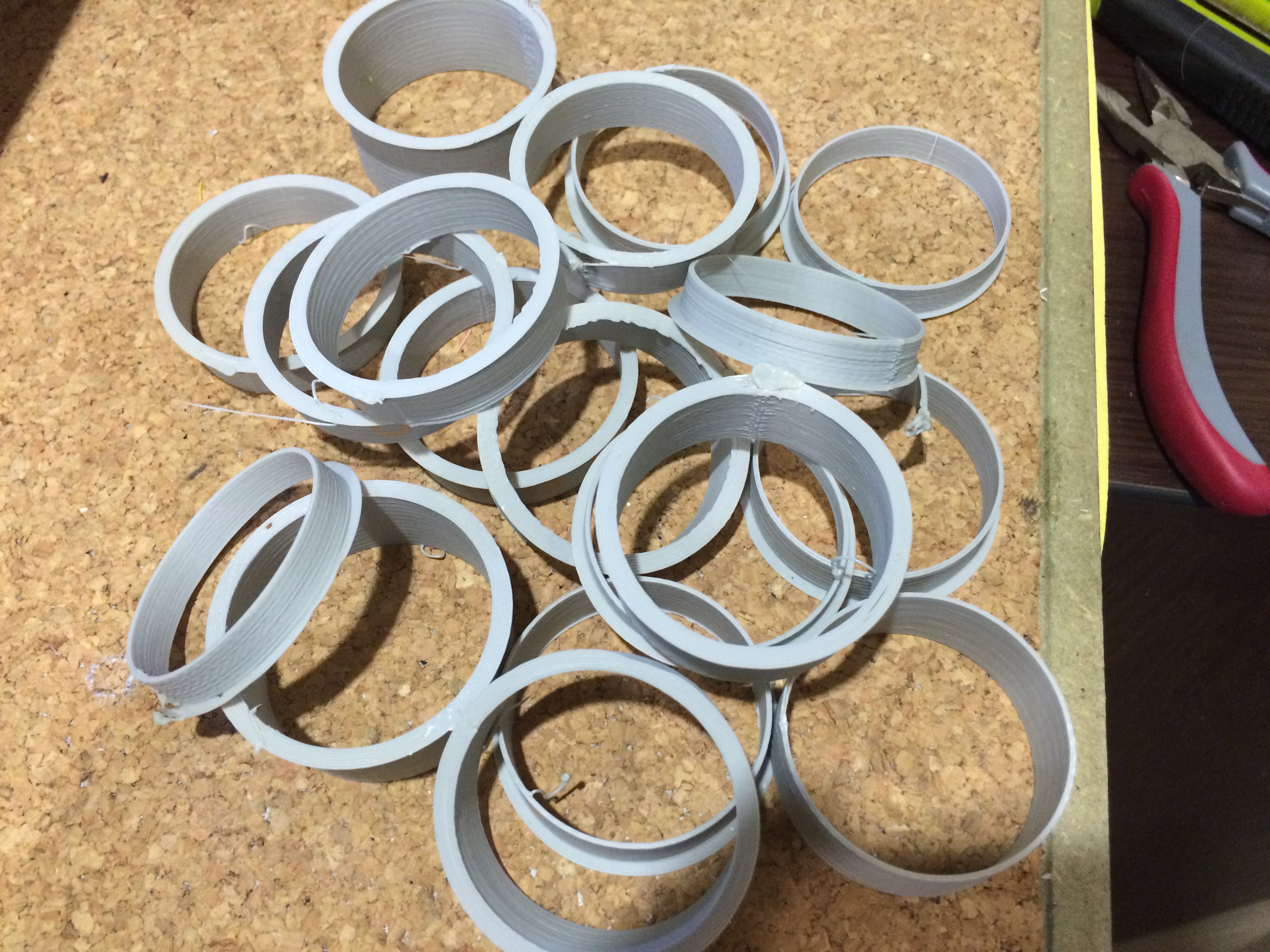

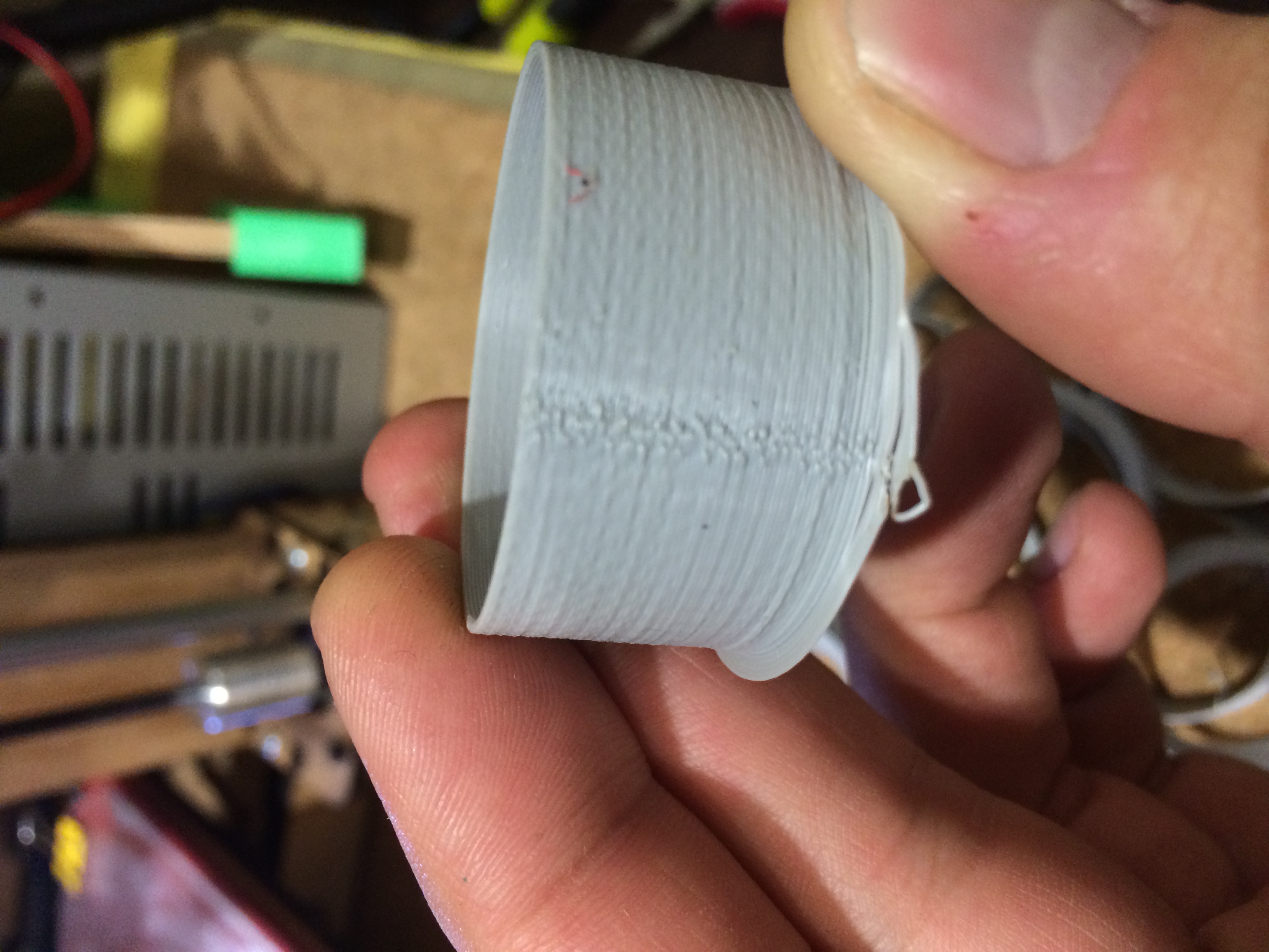

I have ABS 3mm,
at this moment I have made few experiments with same model, that printed multiple times (>20) and mark each then to compare and determine the parameters for the slicing.
Better result
KISS Settings
Loops go from inside to perimeter: ON
Style - Seam hiding
Depth: 0.3
Gap: 1.0
Destring:ON
Wipe:ON
Jitter: 5
Material - Destring[mm]
Prime: 5.9
Suck: 6
Wipe: 5
Speed: 12
Min jump: 2
Trigger: 10
Seam hiding
- Posts: 3

Hmn interesting. I was about to jump ship from Cura and Slic3r but I have never seen seams as bad as those in the "better result" picture. That would make KISS a non starter for me if that is the norm. Is it?
