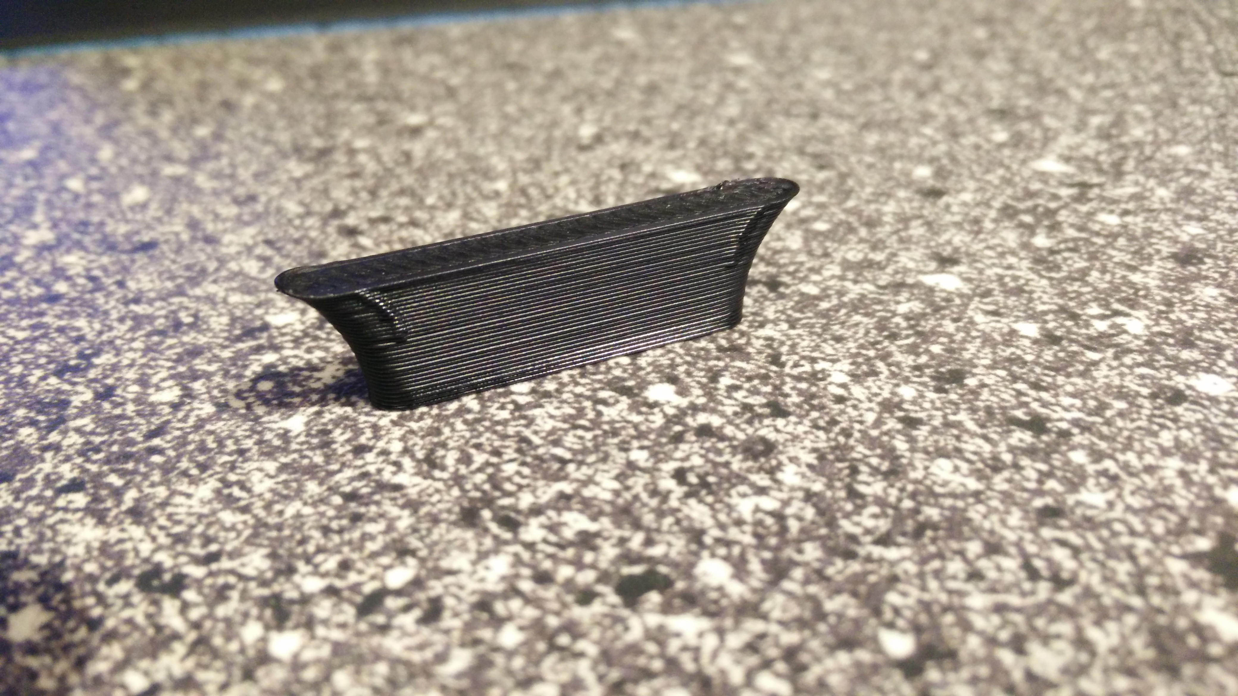

My prints with petg are showing a blob in the areas where the perimter finishes. I think I have calibrated the preload well, but I will re do the calibration later just to be sure. But I wanted to ask some questions:
1.- the vP (mm/s) value, that value is set automatically or I should tune it somehow myself? I habe a bowden setup, bowden is 50 cms long, and the actual value there is 25 mm/s wich somehow sounds low if that value would be a retraction speed. Do I need to tune that value? How?
2.- Aldo Im getting some underextrusion, severe in some areas like in single perimeter support structures. Thing s that same amterial, same printer and basically same setting like speed, temp, etc used with other slicer gives me much better results (with petg), so the only varuable is the preload. Can the preload be causing trpubles like these underextruded areas, or the blobs at the end/start of perimeters?

I was looking in the forum: I found a recent case with a picture showing the exact same blobs as Im haveing: download/file.php?id=1573&mode=view

I think your destring is way too high. When using Preload, destring can be close to zero.
What would I try? Well, maybe reduce destring (3), velDstr (25) and set wipe to zero.
Why? Well the idea is to prevent strings and blobs. This should require only the nozzle "throat"* to be cleared of filament. Destringing too fast will cause separation higher up in the melt zone and will not suck the melted filament back. Including a wipe will have a tendency to suck the melted filament out of the nozzle.

What I see is that there seems to be different aprouchs regarding dstring (retractions). Some people say I should retract as fast as I can, other say to make it slow, s peter recommends. Actually I was retracting at 70mm/s (I recognized I was seeing damage in the filament). I have already tried peter's recomendation and lowered to 30 mm/s with EXCELENT results in petg (what used to be s stringy print now is really clean, despite petg is know to be stringy).
Still need to check my preload calibration because I still have those artifacts in the prints and underextrusion in small circle geometries.
