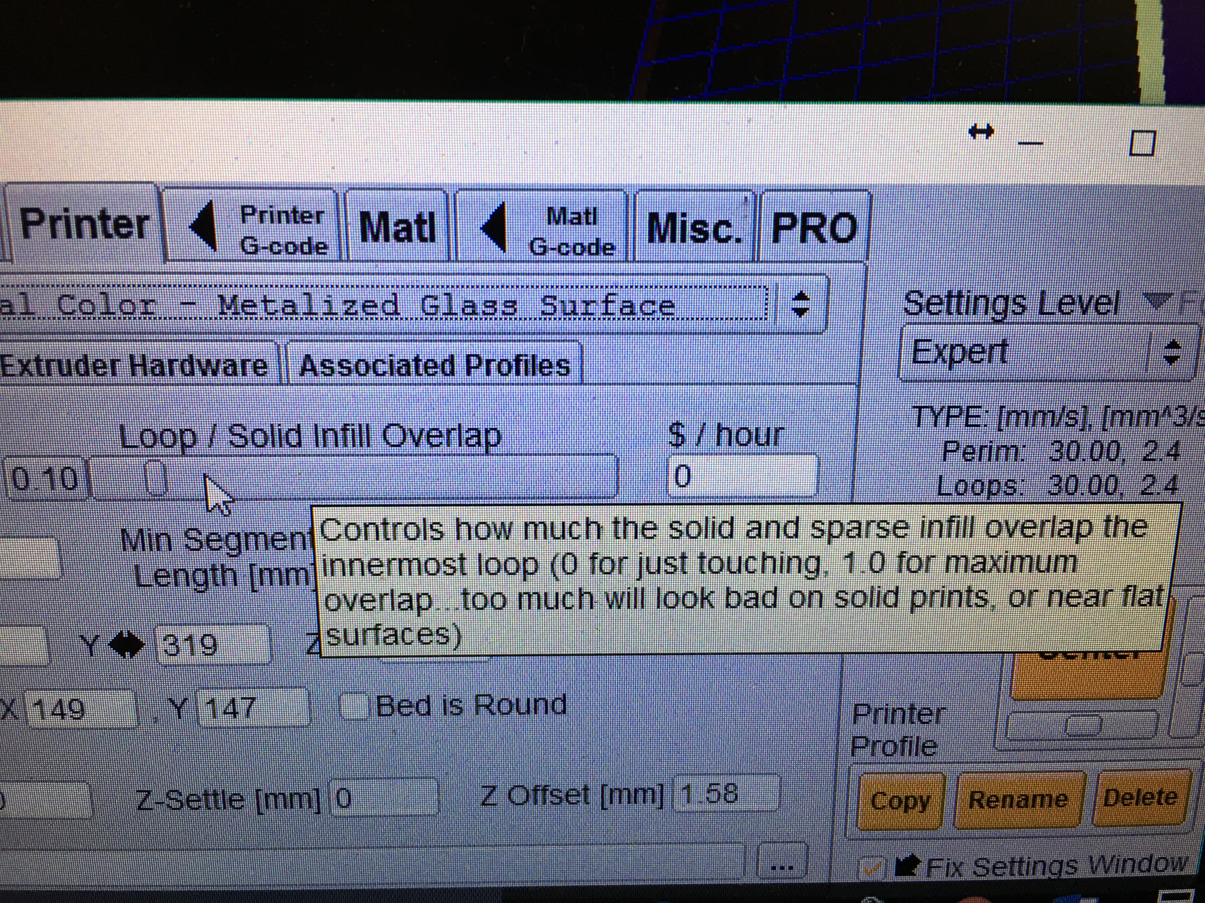

Look at the Printer->Hardware tab. There you have a slider named "Loop / Solid Infill Overlap".inventabuild wrote:Does anyone know the % (or fixed mm) overlap each extruded line has on the one next to it for both loops and solid infill? Is this fixed in KISSlicer or can I modify it?

I'm familiar with that; however the tool tip says that feature only tells how much the infill overlaps the inner loop.
I would like to know how much each loop overlaps the one next to it and how much the Infill paths overlap each other.
