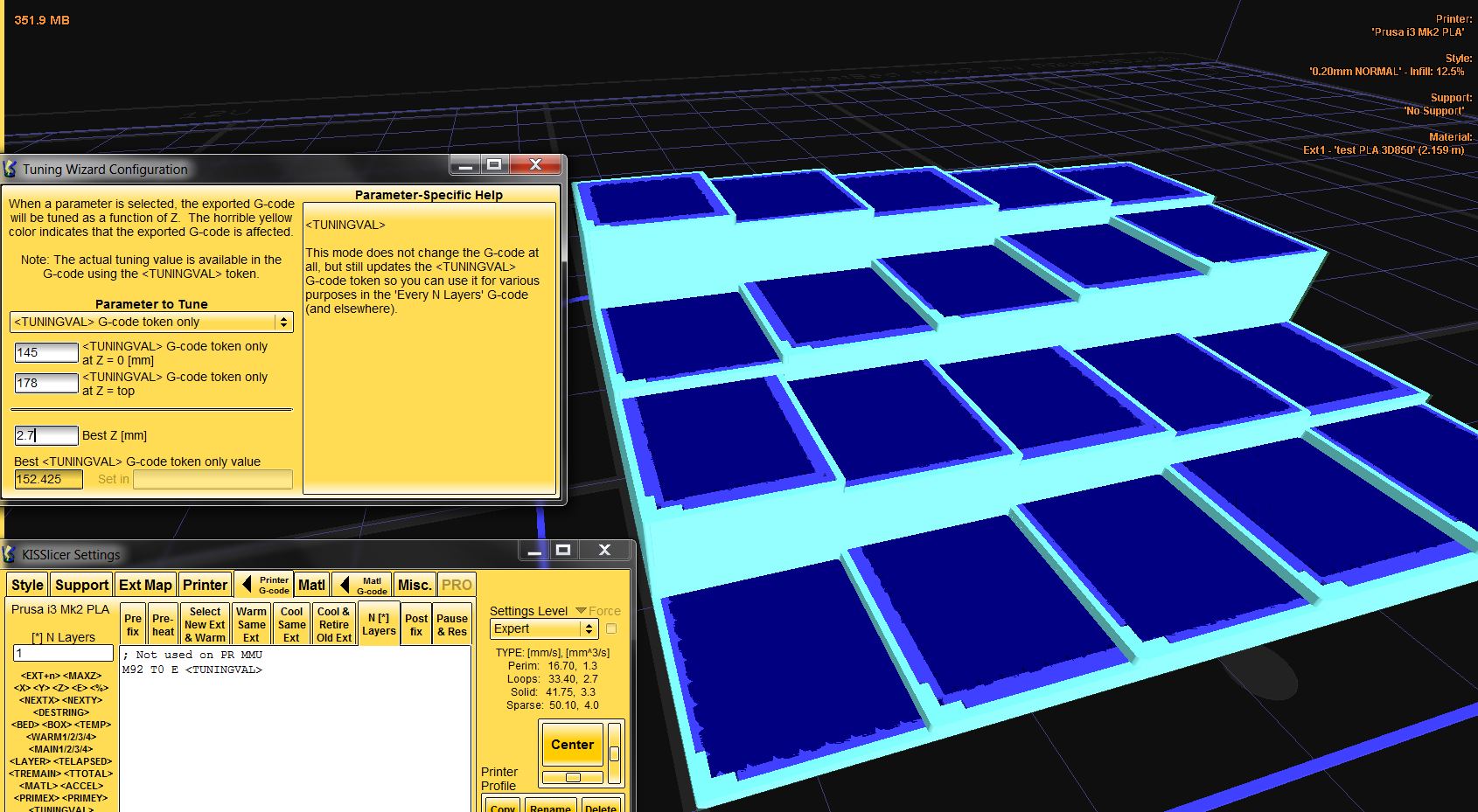

When you have determined the new E-Step value, you need to place the M92 Enew_e-steps_value command in the Prefix Gcode section:
Code: Select all
; Prefix G-Code
T<EXT+0>
M201 X1500 Y1500 E900	; set default acceleration
M301 P24.24 I1.93 D75.95  	; set PID for extruder heater with sock[b] - NOTE: These are my values - yours will be different[/b]
M304 P81.33 I3.91 D423.05 	; set PID for bed heater[b] - NOTE: These are my values - yours will be different[/b]
G21 				; set units to millimeters
G90 				; use absolute coordinates
M83 				; use relative distances for extrusion
M92 Ennn.nn
Peter
lonesock
Posts: 258
Joined: 09 Nov 2014, 18:41
Contact:
Re: Flow wizard
Post by lonesock »
Sorry, I wasn't super clear. I meant that in your postfix you should return the extruder steps-per-mm back to the regular value, so "M92 T0 E161.3". Once you look at the printed model and judge the best Z height, the Tuning Wizard can give you the best possible steps-per-mm from that Z, then you would set your flow tweak to = (Best_TUNING_VALUE / 161.3).
Peter's way works too.
thanks,
Jonathan

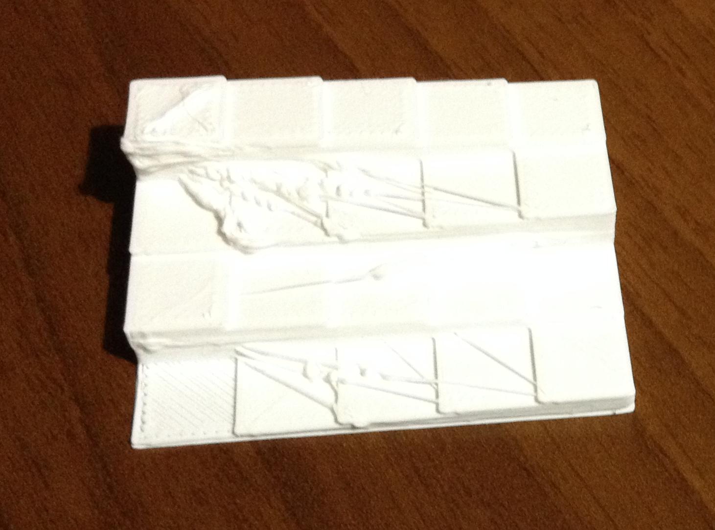

Ok so I've tried the flow tuning as explained and here's the result:
I don't know what went wrong.

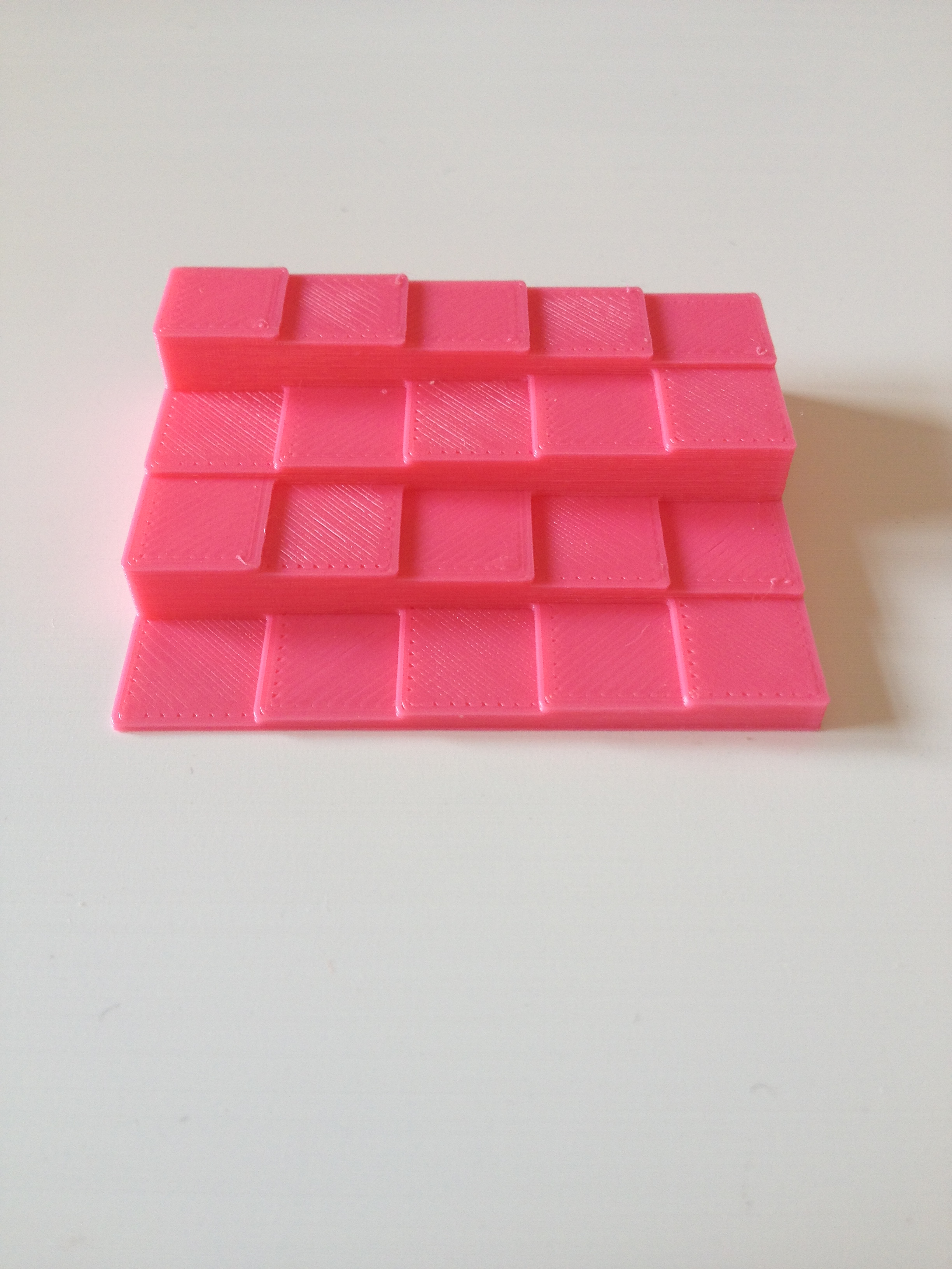

Somedays ago, I've printed it in normal mode flawlessly...:
Any idea of the problem ?
In kisslicer, I don't see any problems...

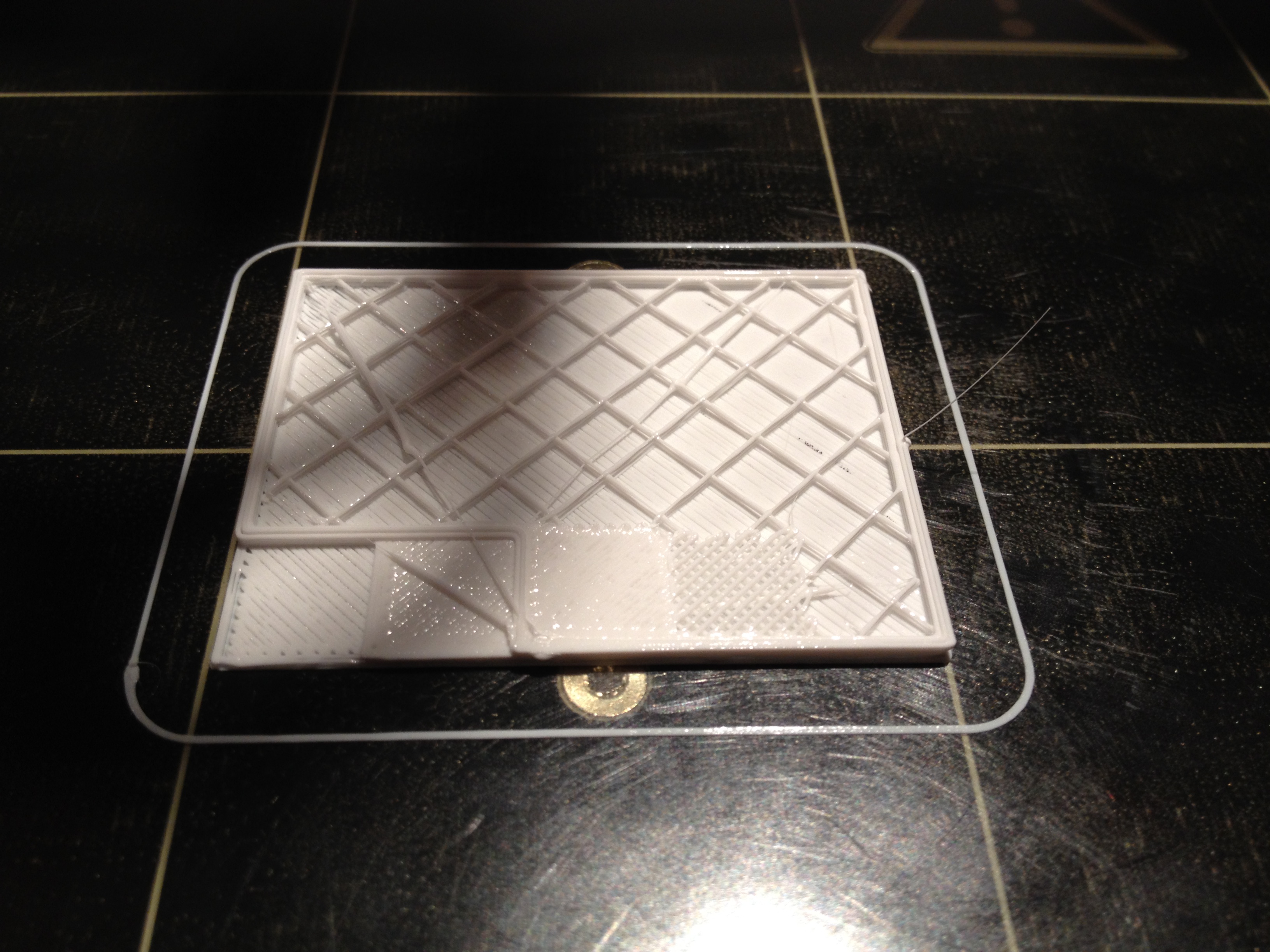

I've removed the space between E and <TUNINGVAL>, it changed nothing. Yet the wizard seems working well because I can see underextrusion on the first cubes and overextrusion on the last cubes, the best ones are somewhere in between...
I've watched the print and the problem occurs when the nozzle ends the infill and jumps to the next layer (and I can hear a noise at this moment, as if the extruder is grinding):
pjr
Posts: 692
Joined: 05 May 2015, 10:27
Location: Kamnik, Slovenia
Re: Flow wizard
Post by pjr »
Do you want to upload the G-code (as a ZIP)?
I will have a look to see what's happening.
Peter
