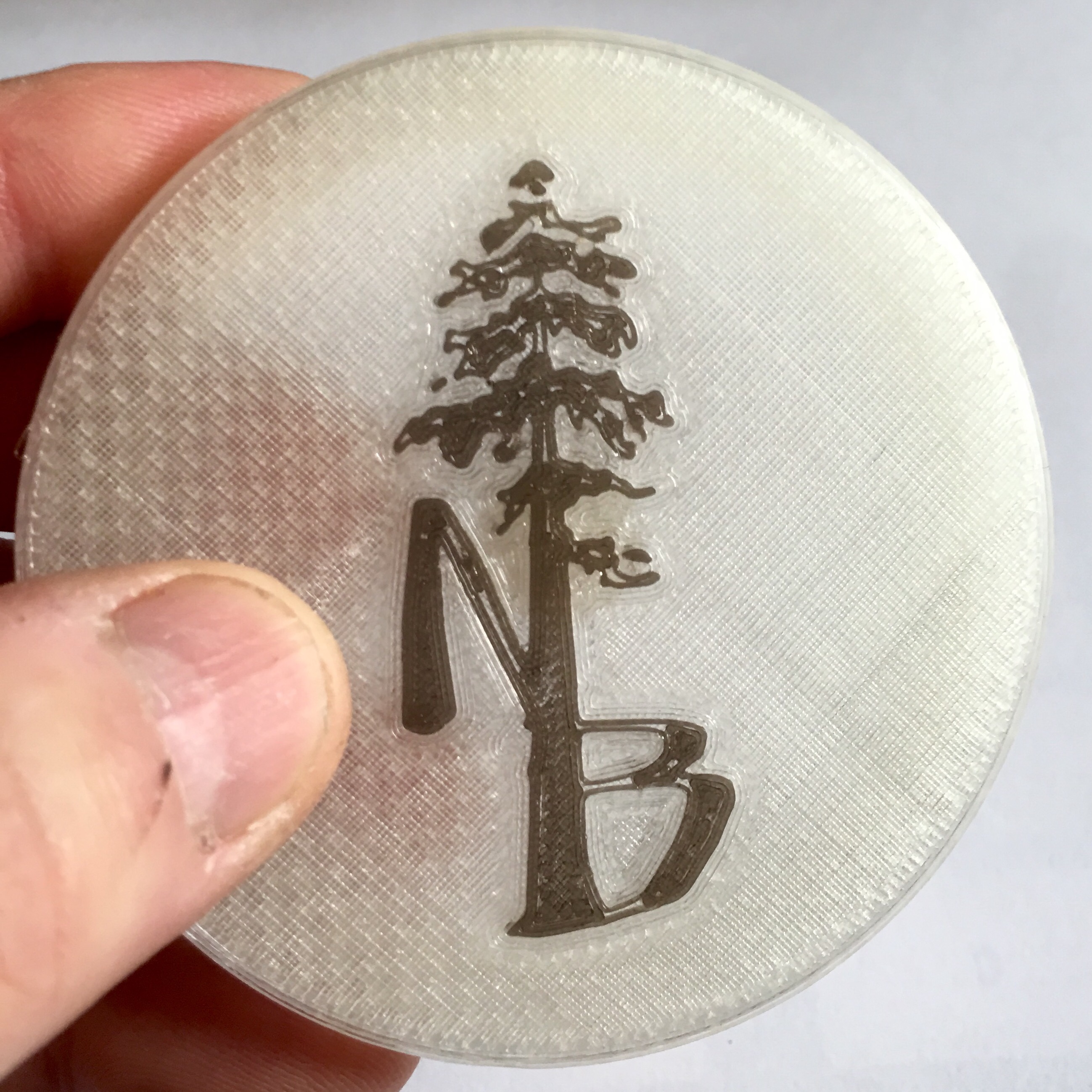

I've spent 1000s of hours studying slicers and their g-code. I'm expert with all the major players: Slic3r (and Prusa Edition), Cura, MatterSlice, Skeinforge, Craftware and Simplify3D to name few. I've also
developed slicing utilities to generate code that current slicers can't - like a 3D printed fishing fly, an SVG file to g-code utility and programs to combine layers from multiple g-code files to get exactly the results I want.
